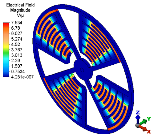

Voltage and Field Strength
Electric Field
Magnitude. The electrical field magnitude results should look as shown in the image below.

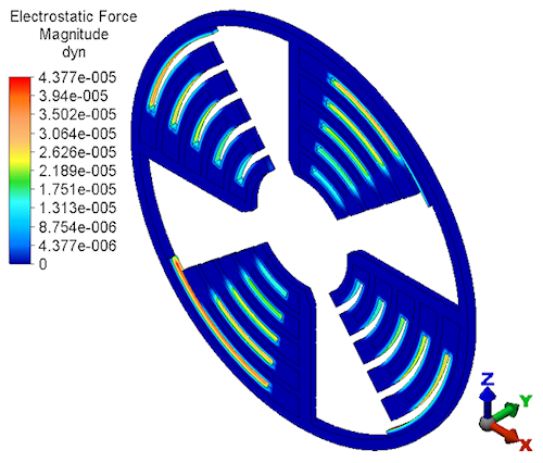

Electrostatic Force
Magnitude. The electrostatic force results appear as shown in the following image.
