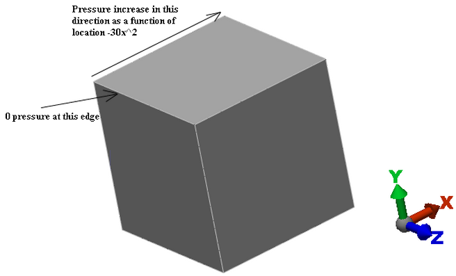

We will set up and view a model of a 5 inch cube with the following variable loading.
First we should set up a rectangular local coordinate that has the origin along the edge of 0 pressure and the local X axis parallel to the direction of increasing load. Next we select the surface and right-click in the display area and select the Add
Surface Variable Load command. The variable load parameters should be set as shown below.

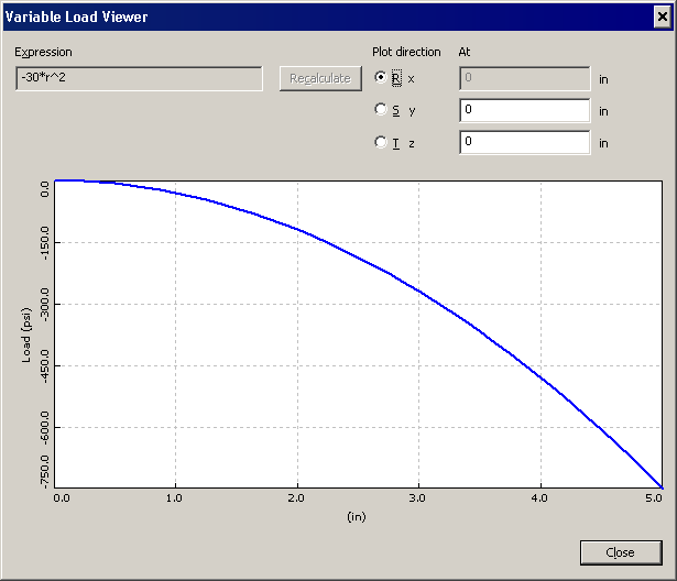

Click the View button to show the following graph along the X direction.

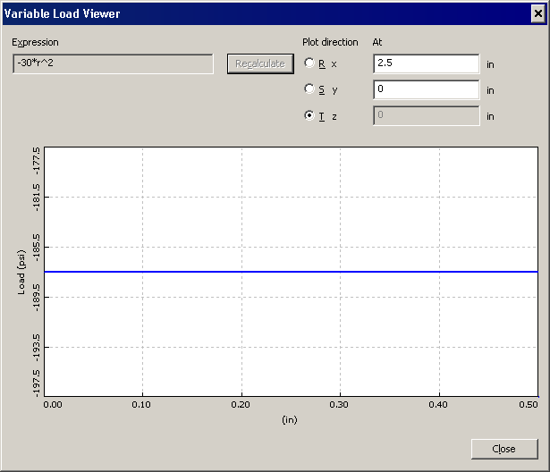

Since the model does not vary in the Y or Z directions, the values in the y and z coordinate fields are not relevant. For verification purposes, the value half way along the surface should be constant at -30*(2.5)^2=-187.5. Select the T radio button and type 2.5 in the R field. Press the Recalculate button. The following graph should appear.
