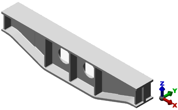

  2. The Choose Analysis Type dialog box appears.
    • Set the analysis type to Linear Static Stress with Linear Material Models.
    • Click the OK button. The model opens in the FEA Editor environment, as shown below.
