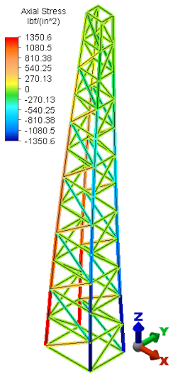

The Results environment shows eight load cases in the annotation at the lower-left corner. These are the three specified frequencies and the five natural frequencies, sorted into ascending order. For each frequency, you may use the options under
Results Options
Analysis Specific
Response Type to view the In-Phase, Out-of-Phase, or SRSS (square root of the sum of the squares) results. We now will view the axial stress results.
Select
Results Contours
Stress
Beam and Truss
Axial Stress. The model displays the in-phase results of the first frequency where the axial stress varies between approximately +/- 1,351 psi.
