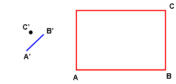

(a) The red rectangle is to be moved so that point A corresponds with point A' on the blue line and rotated so that side AB aligns with the blue line. Relocate & Scale defines the six points. |

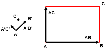

(b) Imagine a right-handed coordinate system created by each set of three points. |
