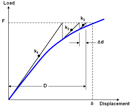

| Figure 1: Convergence Tolerance |
The blue curve shows the theoretical stiffness (Load/Displacement) of a model. The displacement δ for an input force F is appropriate. In a nonlinear analysis, a number of iterations calculate the stiffness along the curve (k 1 , k2, k 3 ,). The solution is considered to be converged when the displacement in the last iteration (Δd) compared to the overall displacement D is less than the convergence tolerance (Δd/D < tolerance). |

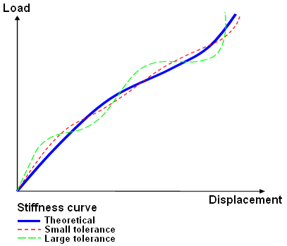

Analyses with large dynamic effects need a smaller tolerance. (Highly dynamic analyses may also require time steps small enough to capture the wave propagation through an element, proportional to the square root of stiffness/mass.) Analyses with simple loading can use a larger tolerance if 10% to 20% accuracy is sufficient. See Figure 2. As with all FEA, multiple runs with different tolerances may be required to determine the effect of the tolerance size.
| Figure 2: Schematic of Effect of Tolerance Size on Solution |
