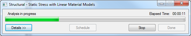

Run Simulation.

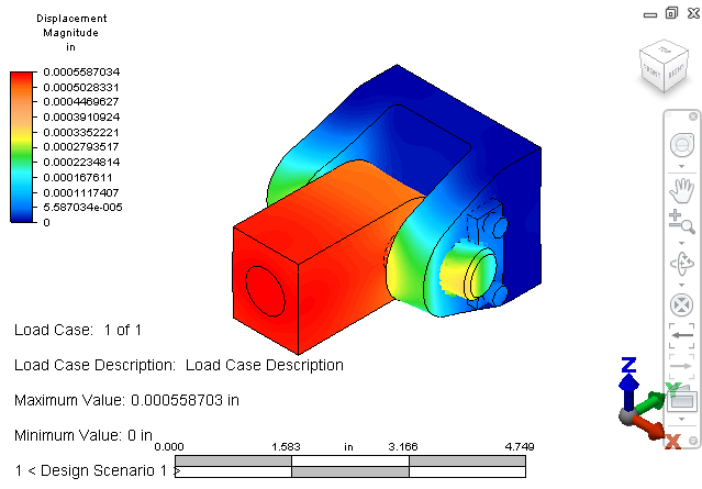

The solver iterates to determine which contact points are closed and which are open. When the solution is complete, the model displays in the Results environment with the displacement magnitude shown by default:
Next, we explore some results visualization tools…
