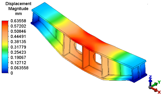

Run Simulation. After solid meshing, the analysis proceeds and the model displays in the Results environment. By default, the displacement magnitude is presented initially. The maximum displacement is approximately 0.64 mm, which exceeds the allowable displacement of 0.5 mm.
