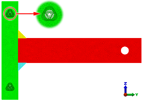

Next, we will apply fixed boundary conditions to the surfaces of both holes in the vertical part.
Visibility
Construction Objects and
Visibility
Construction Vertices to toggle off the display of these items.
Selection
Shape
Point or Rectangle and
Select
Surfaces commands active...
Setup
Constraints
General Constraint.
