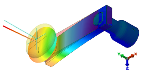

Next, we will look at the displacement results with a transparent view of the undisplaced shape superimposed on the displaced view. Then, we will look at the von Mises stress results.
Results Contours
Displacement
Show Displaced
Displaced Options command.

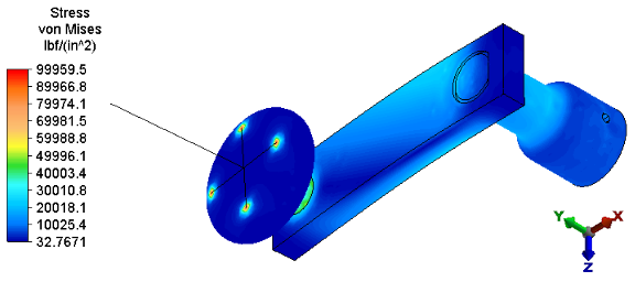

Results Contours
Stress
von Mises. The model displays as shown in the following image. The exaggerated stresses at the beam element attachment points may be ignored.
