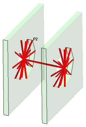

Improper. Rigid elements used to connect two brackets of a larger assembly. The rigid elements (part 2, P2 in figure) are incorrect in this example. Each of the elements within the part do not share a common node. Each rigid element within a part must be connected to one node to create the proper geometry. (Brackets shown with transparency to show the rigid elements more clearly.) |

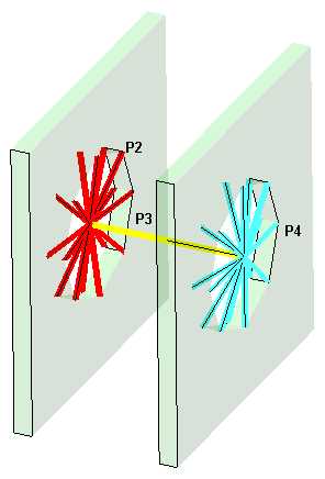

Proper. Each of the rigid elements in each part share one common node. In part 2 (P2), all the rigid elements are connected at one node in the center. Part 4 (P4) is the same way. Part 3 (P3) connects the two sides and can be either one element or two elements (share a node in the center). Part 3 cannot be divided into three elements because they do not share one common node. |
Improper and Proper Rigid Elements |
