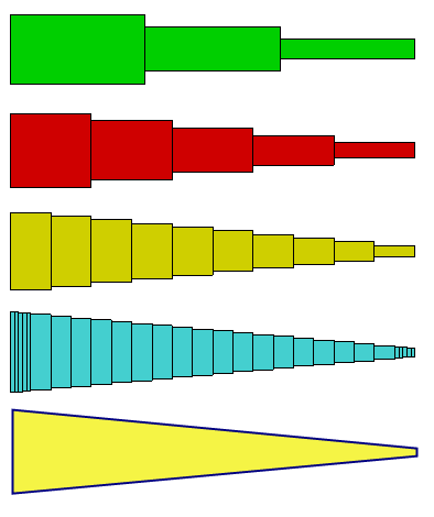

Figure 1: Variable Cross-Section Beam
Four different mesh densities are shown to simulate a tapered beam with a variable height (bottom figure).

  2. Divide the member into the number of elements. Since the taper is approximated, the results will be more accurate if more elements are used.
