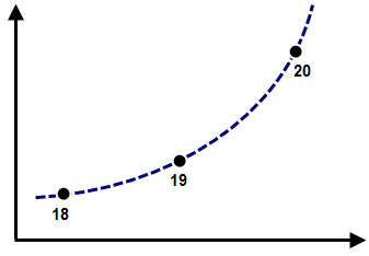

To simulate an accelerating during an analysis, you can create a load curve defined by a second order equation that would represent the displacement of the node under the acceleration. Displacement equals the second integral of acceleration (d = double integral A dt). So based on the acceleration, a graph of displacement versus time can be calculated and entered in to the load curve. For a constant acceleration,
d = d 0 + V 0 *t + 0.5*A*t^2

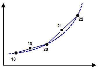

where d 0 is the initial position, V 0 is the initial velocity, A is the constant velocity, and t is the time. Note that for a constant acceleration, two points on the load curve are not sufficient; the displacement is nonlinear with time, so linear interpolation will not lead to a constant acceleration. To produce a smooth, theoretical acceleration, the time step on the load curve must be smaller than the smallest time step that occurs during the analysis. See Figure 1.
displacement |
| (a) The displacements at time steps 18, 19, 20 are defined in the load curve to follow the theoretical acceleration (dashed curve). If the analysis uses the same time steps, then the calculated displacement also follows the theoretical acceleration. |
displacement |
| (b) When the analysis reduces the time step, the displacement at the intermediate steps (steps 19 and 21) are linearly interpolated from the load curve data points (steps 18, 20, 22). Between steps 18 and 20, a linear displacement results in a constant velocity, zero acceleration. Between steps 20 and 22, a different constant velocity, zero acceleration results from interpolating the load curve. At step 20, the sudden change in velocity can result is high forces and convergence problems. |
| Figure 1: Displacement Load Curve to Simulate Acceleration |
