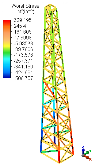

We will now review the worst stress results at the final time step.
Select
Results Contours
Stress
Beam and Truss
Worst. The approximate range of stress is -509 psi (compressive) to 329 psi (tensile). The model appears as shown in the following image.
