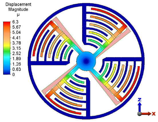

Analysis
Run Simulation. The analysis proceeds and the model displays in the Results environment. By default, the displacement magnitude is presented initially. We will display the actual deformed shape (absolute scale = 1). In addition, we will overlay the undisplaced shape as a transparency over the displaced results.
Results Contours
Displacement
Show Displaced
Displaced Options.
