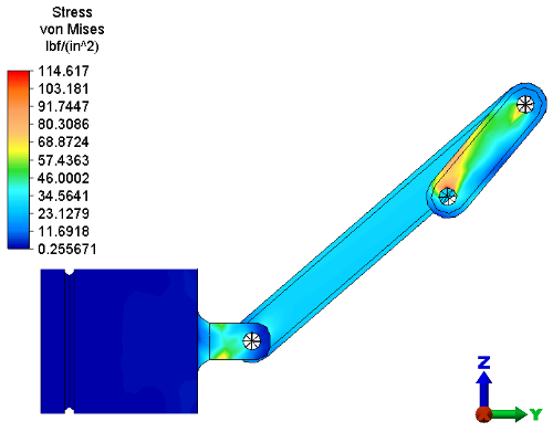

The analysis can take time depending on your computer resources. An archive with results, Piston Results.ach, is available in your tutorial models folder. Use this file to review the results without having to run the analysis to completion. The von Mises stress results at Time Step 5 are shown below.
