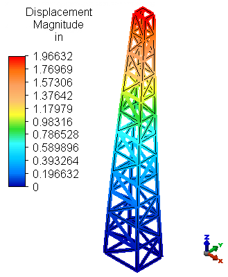

The analysis proceeds and the model displays in the Results environment. By default, the displacement magnitude is presented initially.
If the annotation in the lower left corner does
not
say Load Case: Resultant of 5, then click
Results Options
Analysis Specific
Resultant. The displacement magnitude shown is the resultant of the displacements for the five natural vibrating modes. The maximum displacement magnitude is approximately 1.97 inches, as shown in the following image.
