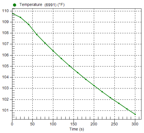

The maximum temperature at 300 seconds is approximately 101°F. We will view a graph of the temperature of a node on the top of the chip throughout the analysis.
Selection
Shape
Point or Rectangle and
Select
Nodes commands active, click a node near the center of the top of the chip.
The temperature of the selected node decreases about 9°F during the analysis. The graph varies slightly depending on the node that was selected.
