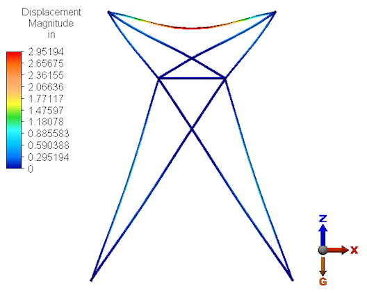

Run Simulation.
The analysis proceeds and the model displays in the Results environment. By default, the displacement magnitude is presented initially.
Results Options
View
Loads and Constraints to hide them. The model displays as shown below.
