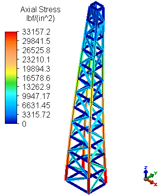

With the resultant of the first five frequencies still displayed, we will now look at the axial stress results.
Select
Results Contours
Stress
Beam and Truss
Axial Stress. Note that the axial and worst stress values are equal, since trusses only support axial loads. That is, there are no bending components.
The maximum resultant axial stress is about 33,157 psi and the model displays as shown in the following image.
