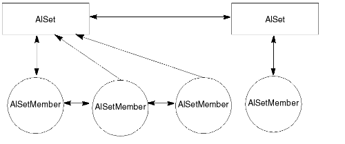

This diagram shows some sets and their set members. A set has no DAG node and is not in the DAG; to get the global list of sets, use the AlUniverse::firstSet() method. To create a set, instantiate and create an AlSet and add members to the set. As with cluster members it is not possible to create or delete individual AlSetMember objects instead, they are created when objects are added to or removed from the set.
