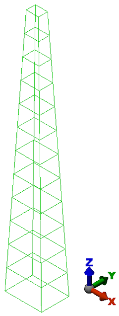

Select View Navigate Orientation Isometric View.
The tower should display as shown in the following image.
