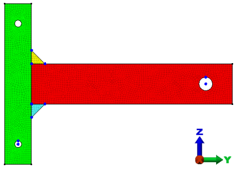

    • Select the directory where you want the file to be extracted.
    • Click OK. The model opens in the FEA Editor environment, as shown below.
