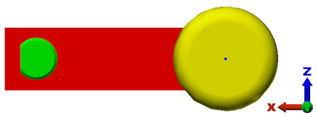

Next, add a construction vertex at the center of the top surface of the knob.  When the mesh is generated, a vertex will be created at this point.
  1. Click  View Navigate Orientation Back View.
  2. Click  Draw Draw Construction Vertex
    • Type -2.25 in the X: field, press the Tab key, and type 2.125 in the Y: field.
    • Click the OK button to add the vertex and close the dialog box.
The model will appear as shown below. The blue dot is the construction vertex just added.
