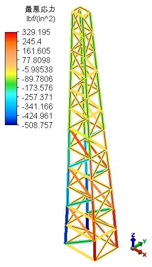

We will now review the worst stress results at the final time step.
Select Results Contours Stress Beam and Truss Worst. The approximate range of stress is -509 psi (compressive) to 329 psi (tensile). The model appears as shown in the following image.
Note: Since trusses only support axial loads, the Axial Stress (Local 1 Direction) and Worst Stress results are identical. There are no bending stresses.
