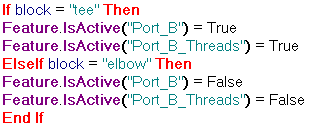

Block_Shape_Rule
Copiar Bloco de Código
If block = "tee" Then
Feature.IsActive("Port_B") = True
Feature.IsActive("Port_B_Threads") = True
ElseIf block = "elbow" Then
Feature.IsActive("Port_B") = False
Feature.IsActive("Port_B_Threads") = False
End If

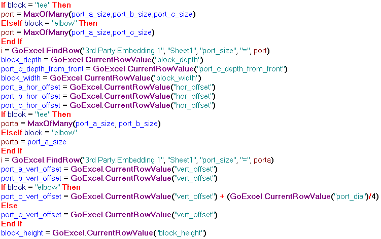

Block_Size_Rule
port = MaxOfMany(port_a_size,port_b_size,port_c_size)
port = MaxOfMany(port_a_size,port_c_size)
End If
i = GoExcel.FindRow("3rd Party:Embedding 1", "Sheet1", "port_size", "=", port)
block_depth = GoExcel.CurrentRowValue("block_depth")
port_c_depth_from_front = GoExcel.CurrentRowValue("port_c_depth_from_front")
block_width = GoExcel.CurrentRowValue("block_width")
port_a_hor_offset = GoExcel.CurrentRowValue("hor_offset")
port_b_hor_offset = GoExcel.CurrentRowValue("hor_offset")
port_c_hor_offset = GoExcel.CurrentRowValue("hor_offset")
porta = MaxOfMany(port_a_size, port_b_size)
porta = port_a_size
End If
i = GoExcel.FindRow("3rd Party:Embedding 1", "Sheet1", "port_size", "=", porta)
port_a_vert_offset = GoExcel.CurrentRowValue("vert_offset")
port_b_vert_offset = GoExcel.CurrentRowValue("vert_offset")
port_c_vert_offset = GoExcel.CurrentRowValue("vert_offset") + (GoExcel.CurrentRowValue("port_dia")/4)
Else
End If
block_height = GoExcel.CurrentRowValue("block_height")
