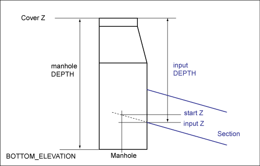

Elevation management ensures consistent values for the heights of related covers, manholes, and sections. The relation between the elevation of the wastewater feature heights and measured depths must be validated. Values that can both be measured or calculated can be compared to validate each other. For example, bottom elevation plus the depth of a manhole should result in the cover height.
Height is a terrain elevation or a height above sea level. Height is usually stored in a *_Z attribute. Depth is a value that is usually measured with a meter rule.

Manhole bottom elevation |
Cover_Start.Z – Manhole_Start.DEPTH =Manhole_Start.BOTTOM_ELEVATION Cover_End.Z – Manhole_End.DEPTH =Manhole_End.BOTTOM_ELEVATION |
| Section input and output Z |
Cover_Start.Z – Section.INPUT_DEPTH = Section.INPUT_Z Cover_End.Z – Section.OUTPUT_DEPTH = Section.OUTPUT_Z |

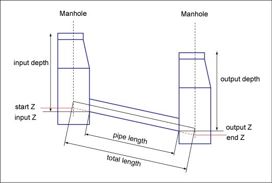

| Slope (section) |
TOTAL_SLOPE = (START_Z – END_Z)/TOTAL_LENGTH PIPE_SLOPE = (INPUT_Z – OUTPUT_Z)/PIPE_LENGTH |

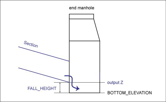

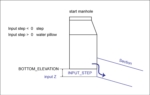

| Fall height and input step |
Section.FALL_HEIGHT = Section.OUTPUT_Z – Manhole_End.BOTTOM_ELEVATION Section.INPUT_STEP = Section.INPUT_Z - Manhole_Start.BOTTOM_ELEVATION INPUT_STEP > 0: water pillow INPUT_STEP < 0: step. |

Wastewater data model: Section with input step < 0
Wastewater data model: Section with fall height
