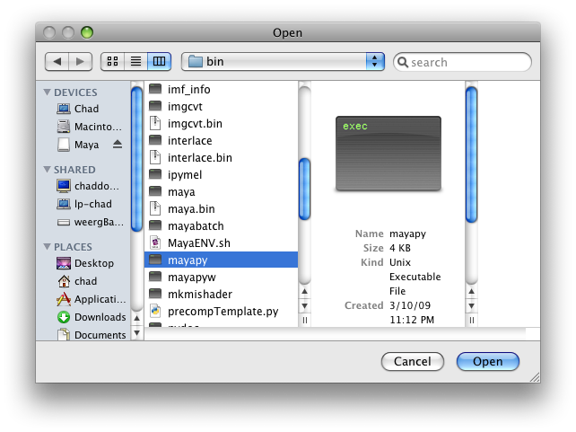

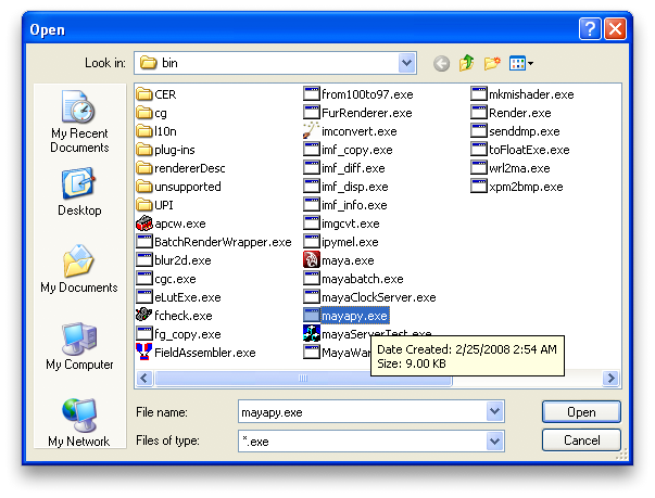

Next, you can either copy and paste the path to your maya interpreter (aka mayapy) or you can click ‘Browse’ and navigate to it.
Note
On OSX, browsing to mayapy is not as easy as it should be. The problem is that it’s buried within Maya.app, which you cannot access in a file browser (thanks Apple!). To get to it, hold down Command+Shift+G to bring up a box to enter a path (that’s the Apple “Command” button, plus Shift, plus the letter G). You can’t use Command-V to paste a path in this browser, but you can right click in the path entry box and choose Paste.
| Windows | OSX |
| C:\Program Files\Autodesk\Maya2009\bin\mayapy.exe | /Applications/Autodesk/maya2009/Maya.app/Contents/bin/mayapy |

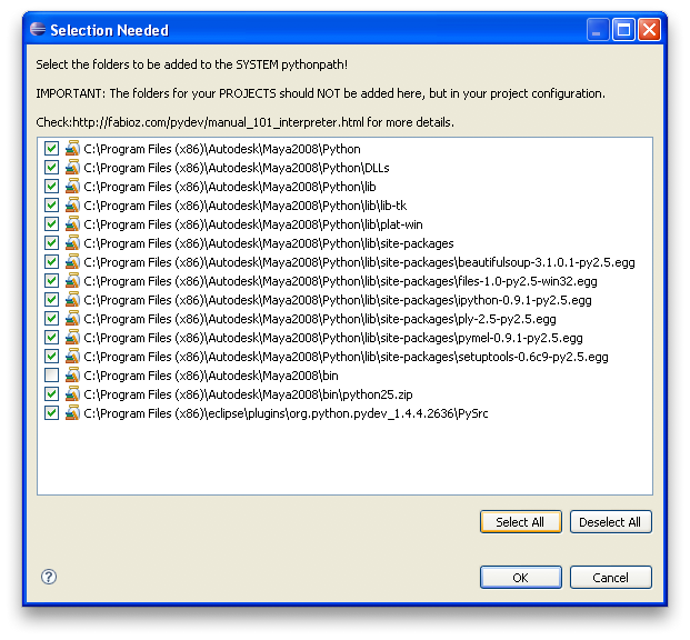

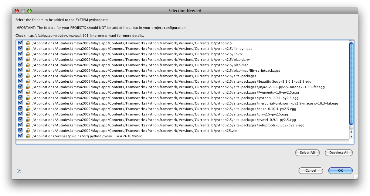

Once you choose the “mayapy” binary, you’ll get this window:
| Windows | OSX |
On windows: add a check beside python25.zip
then press “OK”

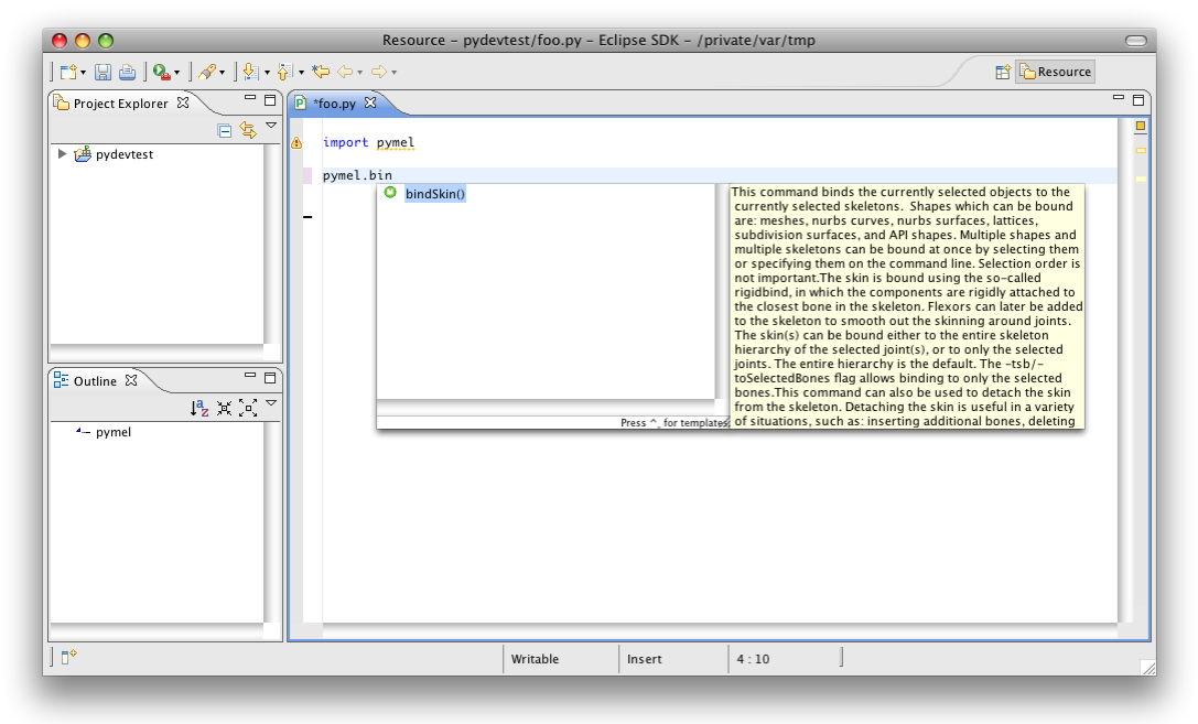

import pymel.core as pm
Save the file. Sometimes this helps force pydev to begin performing completion
Now type:
pm.bin
you should get bindSkin() as a completion.
