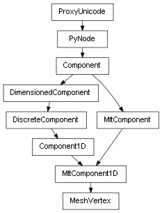

pymel.core.general.MeshVertex
Inheritance diagram of MeshVertex
class MeshVertex(*args, **kwargs)
