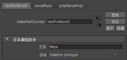

创建 > 文本(Create > Text)动作可以按已设置样式文本的形状创建曲线或曲面。
将下列各项:
// String set: s_TdnTextCurvesStrings // s_TdnTextCurvesStrings.rTextCurvesDefaultFont = "Times-Roman" s_TdnTextCurvesStrings.rTextCurvesDefaultFontLong = "Times New Roman" s_TdnTextCurvesStrings.rTextCurvesDefaultFontWAttr = "Times-Roman|h-13|w400|c0"
更改为类似如下各项:
// String set: s_TdnTextCurvesStrings // s_TdnTextCurvesStrings.rTextCurvesDefaultFont = "NimbusMonL-Regu" s_TdnTextCurvesStrings.rTextCurvesDefaultFontLong = "NimbusMonL-Regu" s_TdnTextCurvesStrings.rTextCurvesDefaultFontWAttr = "NimbusMonL-Regu"
