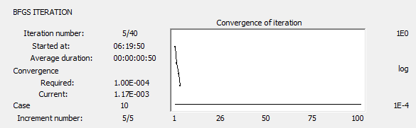

The dialog presents the following values (defined in the Non-linear analysis algorithm options dialog):
Convergence checks are made and iterations are stopped as soon as the state of equilibrium is reached. Displacement increments dUn and the unbalanced forces dFn are then equal to zero, less than the defined accuracy values for both quantities.
