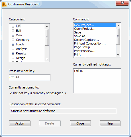

Use the Customize keyboard dialog to you create customized keyboard shortcuts.
- Access
- Click Tools
Customize
Customize keyboard.
Dialog elements
- Categories - Command menu that lets you open a submenu.
- Commands - Commands for the selected category.
- Press new hot-key - Lets you create a key combination - Displays user-defined shortcut keys.
- Defined hot-keys - The keyboard shortcuts defined for the selected command.
- Currently assigned to - Displays the shortcut keys defined for the selected command.
- Description - Displays the description of the command selected from the Command field.
