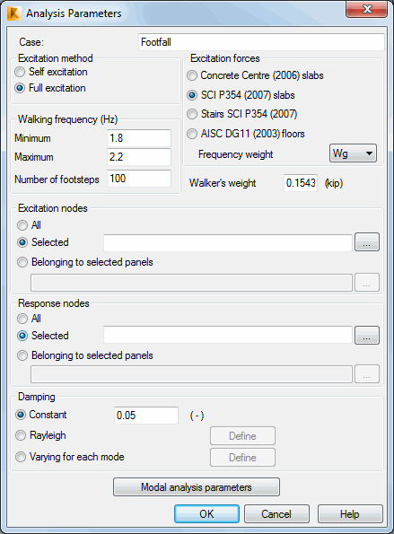

Use the Footfall Analysis Parameters dialog to specify parameters for the analysis of dynamic excitation caused by foot falls from moving individuals or groups, for a load case defined for a structure.
To open the dialog:
You can specify the following parameters in the dialog:
Self excitation analyzes the response in the same node to which the force is applied
Full excitation analyzes the response in any node, to the effect of the force applied to another node
Concrete Centre (2006) slabs according to A Design Guide for Footfall Induced Vibration of Structures, M.R. Willford, P.Young, The Concrete Center 2006; the frequency interval for excitation forces is: 1.0 - 2.8 Hz
SCI P354 (2007) slabs according to SCI P354: Design of Floors for Vibration: A New Approach, The Steel Construction Institute (2007 Edition); the frequency interval for excitation forces is: 1.8 - 2.2 Hz
Stairs SCI P354 (2007) according to SCI P354: Design of Floors for Vibration: A New Approach, The Steel Construction Institute (2007 Edition); the frequency interval for excitation forces is: 1.2 - 4.5 Hz
AISC DG11 (2003) floors according toSteel Design Guide Series 11, Floor Vibrations Due to Human Activity, AISC 2003; the frequency interval for excitation forces is: 1.6 - 2.2 Hz
Frequency weight (Wg or Wb), used to calculate weighted acceleration values for excitation forces according to SCI P354
Click the Modal analysis parameters button at the bottom of the dialog, to open a dialog to define a value of the frequency limit and active mass directions.
