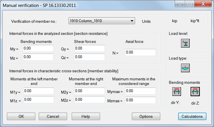

Manual Verification
Use this dialog to verify steel members subjected to the action of user-defined internal forces, according to the requirements of the Russian steel code SP16.13330.2011.
Access
Note: The SP16.13330.2011 code replaces the former SNiP II-23-81 version of the code for steel structures. Therefore, all references to tables or sections of the code apply to the SP16.13330.2011 code except otherwise stated.
Dialog elements
Verification of member no.
Select the member to verify.
Internal forces in the analyzed section
Enter the values of the appropriate internal forces.
The units applied are displayed in the top right corner of the dialog.
Internal forces in characteristic cross-sections
Enter values of the appropriate internal forces on the left and right member ends as well as along the member length.
Load level
Click the Load level icon, and then select a type of load level.
Note: A load level is a load acting on lower or upper flange.
Load Type
Click the Load Type icon, and then select a type of load.
Click the Load level icon to select the type of load level.
Options
Opens the Configuration dialog, which allows you to set the calculation parameters.
Calculations
Runs the calculations.
Once the member verification is complete, a dialog displays the calculation results.
Note: When running a manual verification, the intermediate stiffeners defined in the Member definition dialog are not taken into account, and the member is treated as a member without stiffeners along its length.
