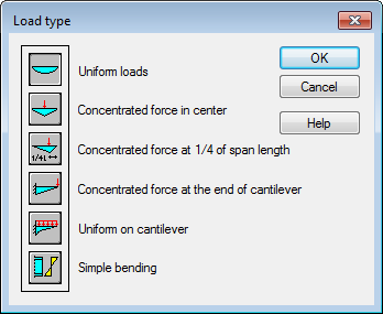

Use this dialog to define the load pattern of the analyzed beam.
Access
- Click the Load type button in the Member Definitions - Parameters dialog.

Dialog elements
The information concerning the load type is applied in the calculation of the ψ coefficient value ( Tables Ж.1 and Ж.2), which in turn is used for the calculation of the lateral buckling coefficient according to Annex Ж.
