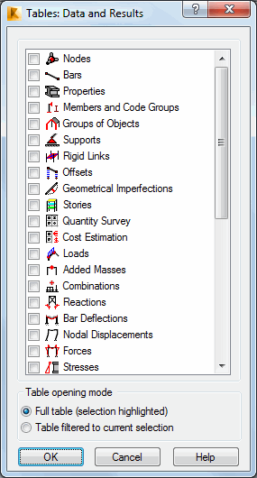

Tables: Data and Results dialog
The Tables: Data and Results dialog lets you select tables for the presentation of data or calculation results.

Dialog elements
Data tables
    You can select the following types of data tables:
  • Node table
  • Bar table
  • Table of section properties
  • Table of members and groups used in structure designing
  • Table of structure supports
  • Table of rigid links
  • Table of offsets
  • Material table - (not currently available)
  • Table of geometrical imperfections
  • Table of structure stories
  • Table of data set (quantity survey) and cost estimate
  • Cost estimation table
  • Load table
  • Added mass table
  • Combination table
  • Panel table
  • Solid table.
Results tables
Table opening mode
The following options at the bottom of the dialog specify how the data or results tables are opened:
  • Full table (selection highlighted) - When selected, the entire (full) table is opened. The rows that are assigned to the selected nodes, bars, or objects are highlighted.
  • Table filtered to current selection - When selected, only the rows assigned to the selected nodes, bars, or objects are displayed.
Note: If you display a results table, and there are no current structure calculation results, Robot automatically begins structure analysis and calculates the selected quantities.
