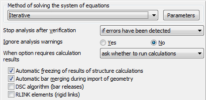

Use this dialog to set up the solver parameters.
Click Parameters to select a renumbering method for the SparseM solver.
Click Parameters to select a type of Iterative solver.
Select Never if you want to run the calculations even if errors or warnings are found.

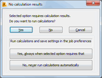

Such options include result tables and diagram or map selection dialogs. Prior to running calculations the following dialog displays:
This dialog also displays after opening a file saved without results, but with a table, diagrams or result maps active.
The Automatic option of the structure analysis parameters relies on a set of rules.
In this case, the program performs a fast symbolic factorization procedure. The number of non-zero elements is defined for both renumbering methods: NDM and MDA.
The NDM method activates the Sparse solver, and the MDA method activates the SparseM solver. If neither the NDM nor the MDA method is selected, then the program uses either the skyline solver or the frontal solver.
