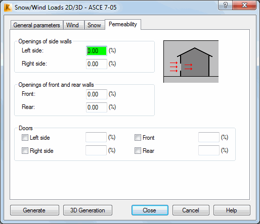

Opening the Snow/Wind Load dialog and clicking the Permeability tab displays the following dialog.
The dialog box is used to define the permeability of structure walls. Wall permeability has a direct effect on generating coefficients of wind pressure inside a structure. When you select an option its diagram displays in the upper-right corner of the dialog.
Note: Permeability is always given in %. Permeability of an entirely open wall equals 100%, whereas for a wall entirely enclosed it equals 0%.
The dialog is divided into 2 fields with groups of specific options.
In the Openings of side walls and Doors fields are the following options:
The Openings of front and rear walls field has options for defining values of wall permeability (front, rear, in the front, and in the back).
