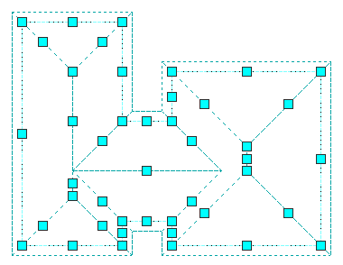

  1. Select the roof.
  2. Select the grip for the dimension you want to change.
    Roof grips
  3. Move the grip until the dimension value you want is displayed, and click once, or enter a value.
