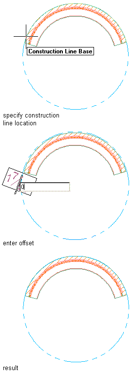

    Drawing a construction line at a zero offset based on a straight wall segment

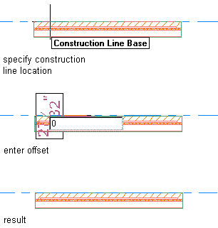

    Drawing a construction line at a zero offset based on a arc wall segment

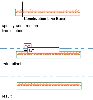

    Drawing a construction line at a specified offset based on a straight wall segment
