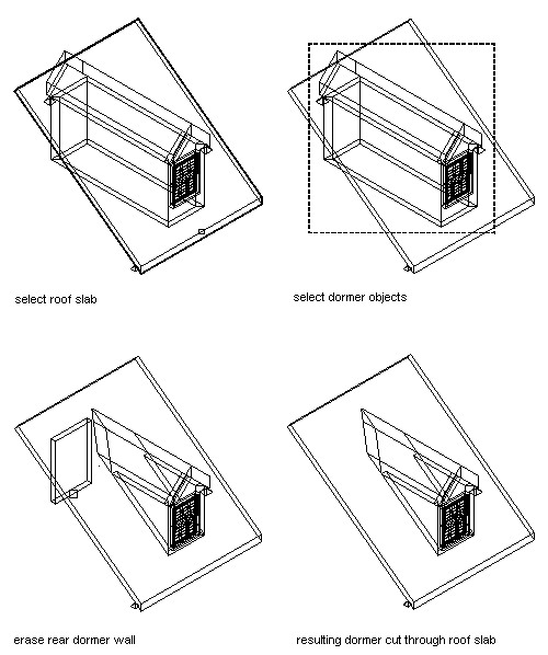

- Move the structure so that the walls and roof slabs of the dormer fully penetrate the existing roof slab in the correct position.
- Select the roof slab to add the dormer to, and click
- Select the objects that form the dormer, and press Enter.
- When prompted to slice the walls with the roof slab, press Enter to slice the walls, or enter n (No) to leave the walls as they are.
- Erase the wall at the rear of the dormer.
