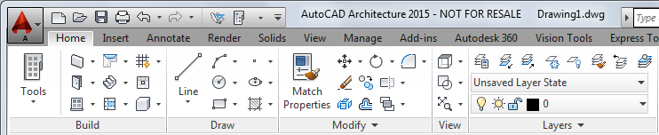

The Ribbon
Similarly to Microsoft Office, AutoCAD Architecture uses the ribbon as the central access point for commands. The ribbon contains a number of tabs on which commands are grouped according to conceptual task types or selected objects.
The ribbon replaces the menu bar and the toolbars as the primary command access point.

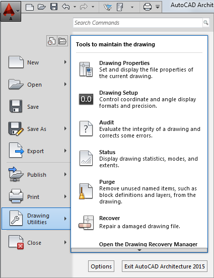

The Application Menu
The application menu contains basic commands pertaining to the drawing as a whole, such as Open, Save, Print, and Export. Like the menu browser it replaces, the application menu is accessed by clicking in the upper-left corner of the workspace.

The drawing status bar menu has been removed from AutoCAD Architecture. Commands formerly found there can now be accessed from the application menu.
Commands on the old menu

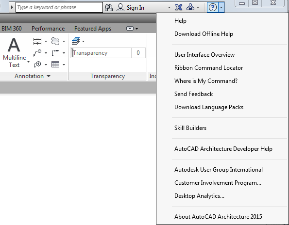

Help Access
With the removal of the menu bars, the commands to access Help features have been moved into the InfoCenter at the top right of the application window. Here, you can find the online resources of InfoCenter and the Help menu, which lets you access Help, Tutorials, and other interactive resources.

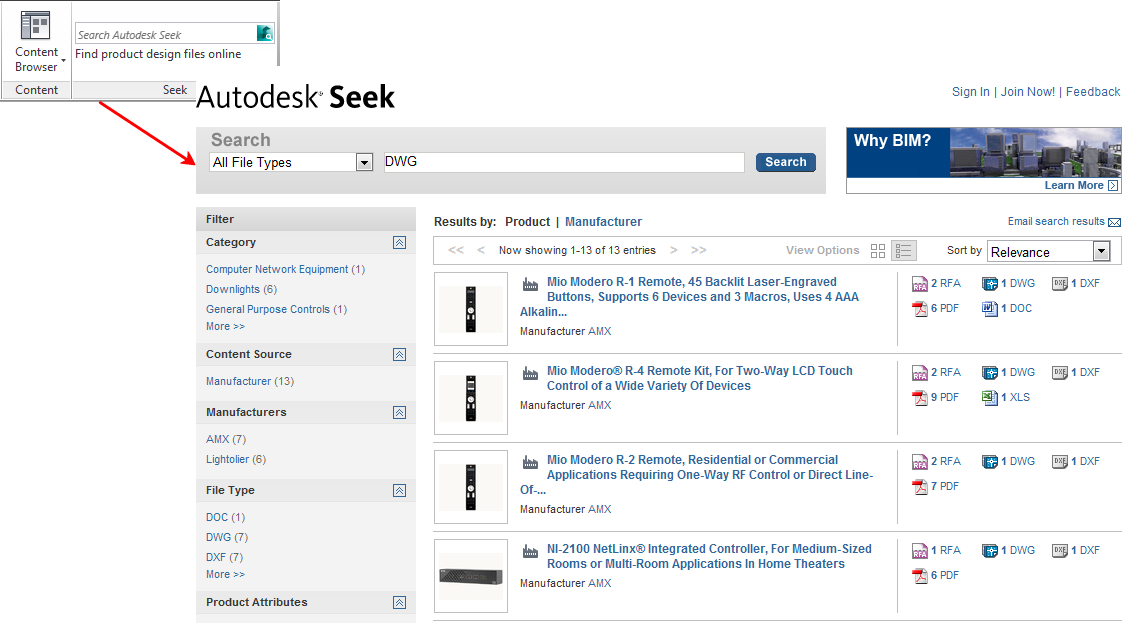

Autodesk Seek
You can use Autodesk Seek to find product design information. Many content providers, both corporate partners and individual contributors, publish to Autodesk Seek. Content includes 3D models, 2D drawings, specifications, brochures, and other descriptions of products or components.
Import design content into AutoCAD Architecture
You can also share your own content with others using Autodesk Seek. Upload drawings or blocks to Autodesk Seek to give your partners and customers ready access to your content.
