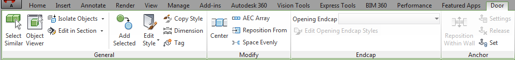

You can modify an object using any of the following methods:
- Object-specific (contextual) ribbon tab: When you select an object, an object-specific tab is displayed on the ribbon. For example, when you select a door, the Door tab displays. The object-specific tab contains commands that apply to the selected object.

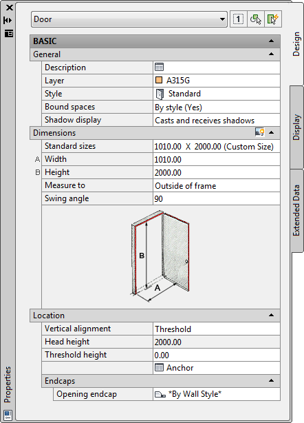

- Properties palette: The Properties palette is one of the central locations for entering and changing information about an object. This palette has categories that group the properties by type.

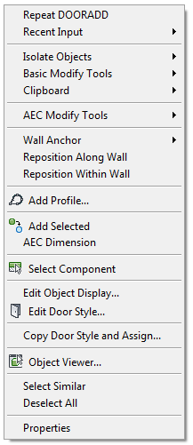

- Context menu: Right-click the object to display its available commands.
Door context menu
