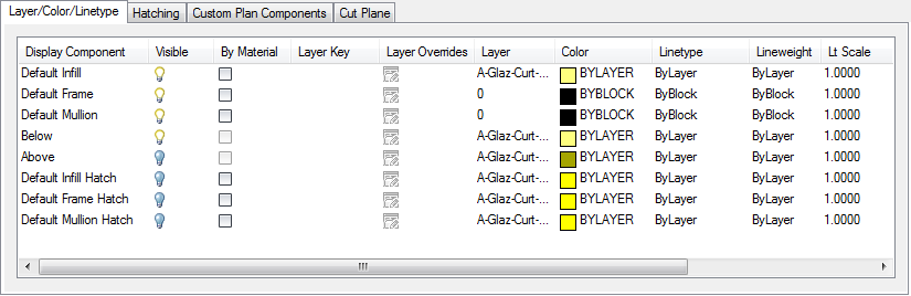

    If you add a cut plane … Then …
    at a height that is lower than the value for Cut Plane Height objects are displayed using the properties specified for the Below Cut Plane component on the Layer/Color/Linetype tab.
    at a height that is higher than the value for Cut Plane Height objects are displayed using the properties specified for the Above Cut Plane component on the Layer/Color/Linetype tab.
    Below and Above components
