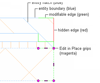

  5. On the Layer/Color/Linetype tab, change the properties of the following components:
    • Entity: this component controls the display of the object on which you edit a component in place. For example, if you edit a wall endcap in place, this display component controls the wall boundary.
    • Hatch: this display component controls the layer/color/linetype properties of the hatch of the temporary profile. This is independent on any hatches assigned to the object itself, and will be displayed only in edit-in-place mode. By default this component is turned off.
    • Modifiable edge: this display component controls the display of the active edges of the profile that can be modified.
    • Hidden Edge: controls the display of object edges that are hidden from view. When you hide an edge, and exit the edit-in-place mode, it will not be displayed. When you are in the edit-in-place mode it is displayed as a red line.
