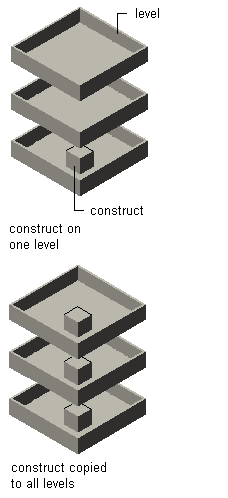

Use this procedure to copy a construct to multiple levels.
Copying constructs to levels is an easy way to fill multi-story buildings with content. You draw the construct for the first level, and then create a copy of that construct for each level you select.
Copying constructs to all levels schematic
