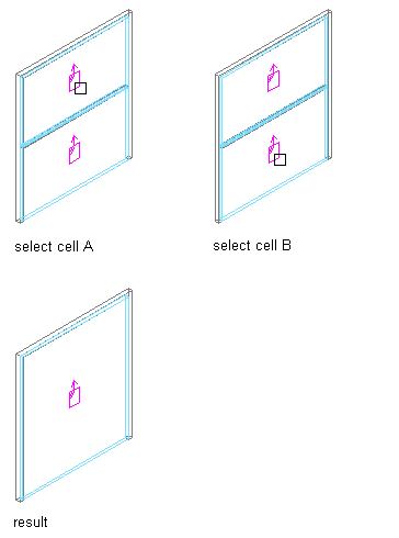

Merging two Door/Window Assembly cells
  1. Select the door/window assembly on which you want to merge two cells.
  2. Click Door/Window Assembly tab Modify panel Infill drop-down Merge.
  3. Select the first cell to be merged.
  4. Select the second cell to be merged.
    The cells are merged into one.
