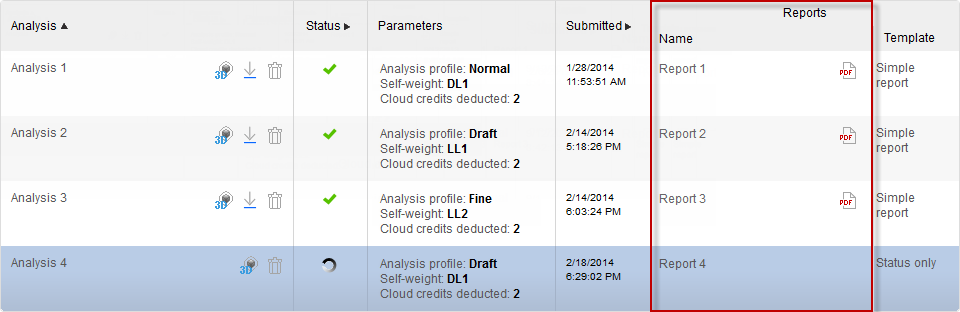

Results are available in the form of predefined analysis reports on the Autodesk® 360 Structural Analysis website. You can view them in the HTML or PDF format. You can also download and save them locally.
To view a report from the website
  1. Select the model.
    The Model page opens and displays all performed analyses in your model.
  2. Locate the row that contains the selected analysis, and then click the report link (for an HTML format) or click the PDF icon.
