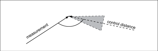

Control distances are measured between new detail points of the current calculation project, and one or more existing points. The control distance analysis performs the following steps.
If FS is within the threshold, the system continues to check whether the measuring direction is appropriate to provide a valid check.

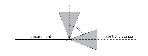

If case 1 is not successful, the system continues to check case 2.
To control a GPS point, you must measure two control distances according to case 2.
You can change the default threshold of +-13.5 degrees system table TB_SUR_SETTING, key CONTROLDISTANCE_GEOM_CHECK_THRESHOLD. The unit is the document angle unit.
