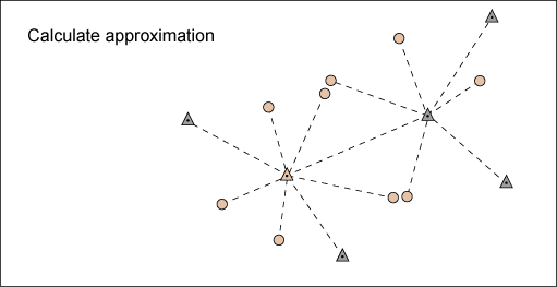

In the fourth calculation step, you calculate approximate coordinates for the every unknown point. For GPS sessions, the calculation determines the transformation parameters. For tachymeter sessions, the calculation determines the orientation for each station.
The approximate coordinates are used to find identical points, and as input for the adjustment calculation.
